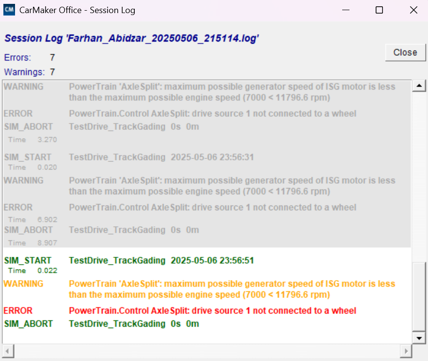

I tried to change my powertrain model from conventional to axle split hybrid but when i try to start the simulation this error occurs. What causes the error to occur and how to fix it? thank you

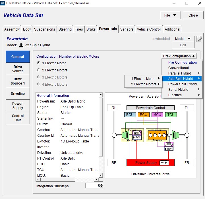

it seems like you something is not right with the configuration of your powertrain set up. One hint I could give you is, that there are some pre-defined configurations provided by the software. You can find it under the sub tab General (Powertrain → General → Pre-configuration). You could try choosing this set up and change it according to your needs. I have attached a screenshot of how it looks like.
