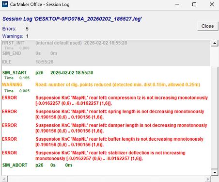

I tried to put the values the file of the IPG kinematics (skc) file at Carmaker, the problem is that this error is showing all the time. I tried to change some values at the rear.

I think the error message is giving you a lot of information of what is wrong
It looks like you have at least two entries which are exactly the same (0,17) & (1,17)

I have the exact same Errors for my rear suspension. How did you solve this problem, because I tried some sollutions and still nothing. Do you need any file?

.The error message actually provides a good indication of what’s going wrong. It appears that you have at least two entries that are exactly the same: (0, 6) and (1, 6).
I’m not sure how many points you’re using for the suspension mapping, but based on the error, both (0,6) and (1,6) seem to have the same value. Assuming the first input corresponds to compression (comp), this means you’re defining the same output for two different heave positions, which is causing the conflict.
Hello @jose.nevado ,
So the problem should be fixed from the geometry by changing the x,y,z of the wrongs parts or from an other window?
