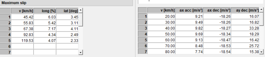

I’m attaching an image of my slip map and ax, ay table so you can see what values I get because I’m not sure what you meant by looking at them, I don’t know what it is I’m looking for.

From the values that i can see in the table, there are some wrong numbers. For example it is not possible to have at v=30 km/h ay=16.82 m/s^2 and the suddenly at v=40km/h it is ay=33.28m/s^2 and then it drops again at 50km/h at ay=18.29. The values should be getting higher with a normal rate. Those jumps at values are not normal. If you make a new driver and you train it again it generates that same values? You can change the values manually. Try putting some logical values at the table and watch how the drivers does. Now for the the line that the driver takes. Does he go completely of the track or it just cuts some corners and goes wide at the exits?

Doing a new driver and training again did come out with the same results, but manually changing the ay values to have a smoother incline without spikes at certain speeds made it so the vehicle completed the course, staying in the track and not hitting any cones. I’m not sure why the adaption causes such a strange generation of lateral accelerations, but I’m glad to have a strategy which works now so thank you for the help.

The generation of these bad values at ax and ay might be due to the tire model that you are using. Also take a look at the parameters of your vehicle, it might be there something that generates this problem. Also a random question, what kinematics model do you use? skc, linear 2 DOF etc. I need some help with my model and i was wondering if you could give me some help.
