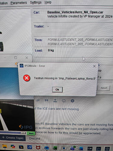

In the LTS project, FS Baseline ICE Vehicles do not move. it gives an error, stating “Testrun missing in ‘name of computer’” appears at the point you press start on the simulation in the main GUI. If you then click ok the car remains stationary for 200 seconds before timing out. When using EV’s the test run behaves as expected and does not receive the testrun missing message. This is happening to all ICE vehicles in all simulations.

Hello Fiona,
Please try saving the test run before starting it, that should avoid this error message.
With regards to the ICE car not driving, I suspect the shift knowledge is missing so please run a driver adaption after selecting the ICE car so that the driver can learn which gears are needed at which speeds.
