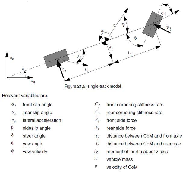

The figure below shows some of the naming convention found on the ReferenceManual.pdf
