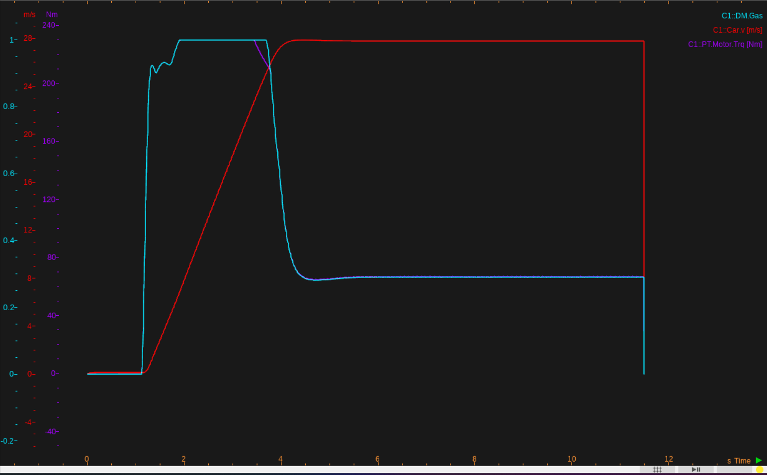

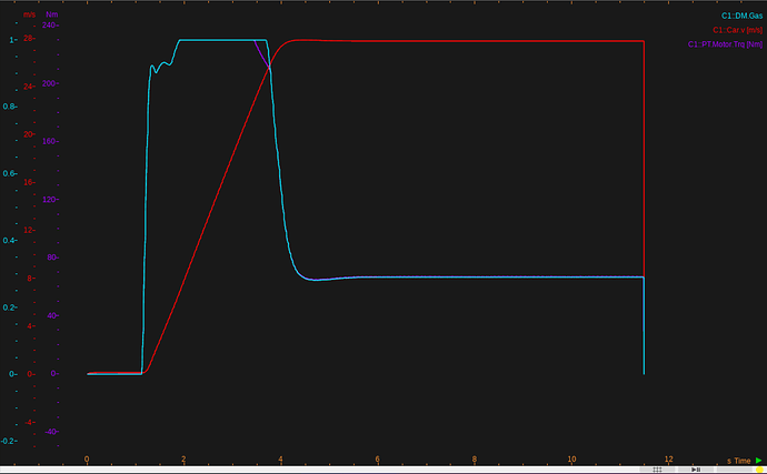

Hi, i have been doing some sims on lap times to evaluate our car, came back to the simple top speed and 75 m acceleration style to reavaluate and found something strange, when analysing the top speed (FS type car)

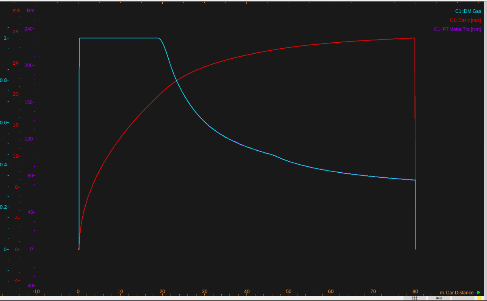

everything was normal, but when i did the 75 m

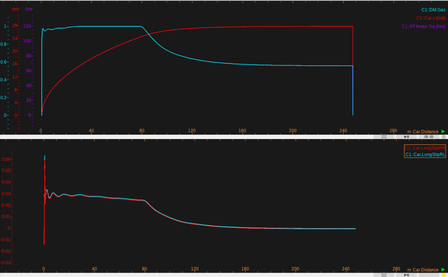

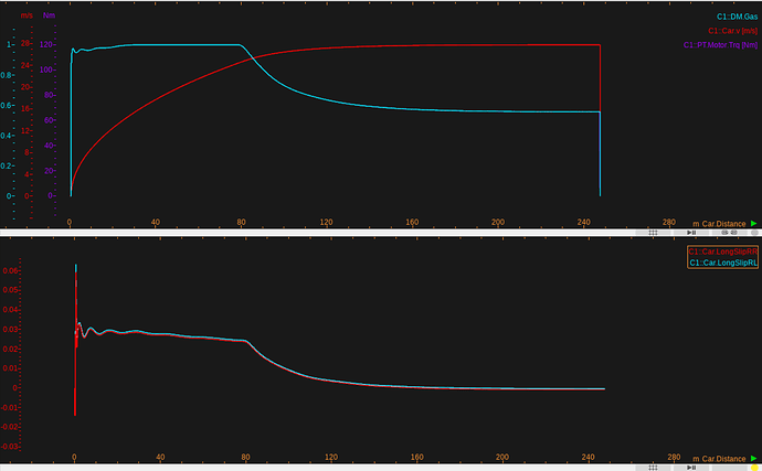

the car tends to stay at 100 km/h, did 250 m and still happened

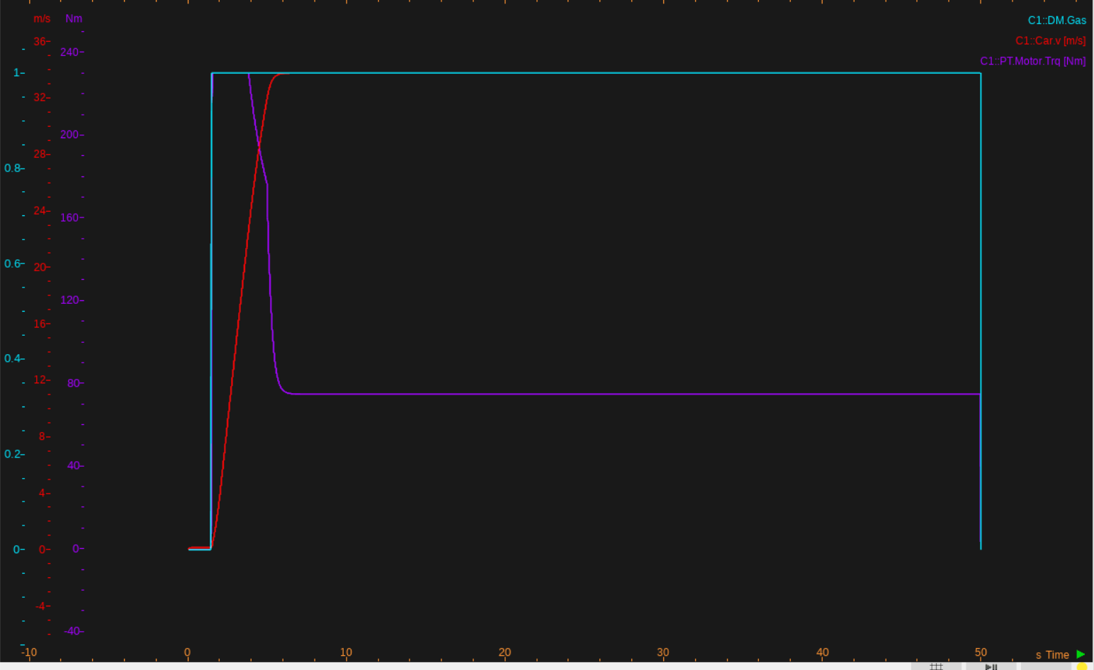

The driver stops accelerating when reaching the 100 km/h mark. In Autocross/Lap events this isn’t noticeable since the car does not reach the top speed.
Even when changing tyres/cars to the default ones didnt do anything, checked and it iss’t a problem of LongSlip. (Also with default driver(agressive))
Hello @grams ,
could it be that you created your own track for the 75m acceleration test? If yes, please check the link parameters. I guess you used the default settings, which would mean you created a country road in Germany, which has a speed limit of 100km/h. You can simply set the Road Type to “Undefined” and it will not have speed limit (please refer to pages 84/85 of the User´s Guide/CM13.1.1).
Thanks for the reply, the problem was on the road type as you said. However the 75 m track used was the one provided by IPG on the formula pack.
Thanks for the info! We put it on the list of things to change for next season. :slight_smile:
